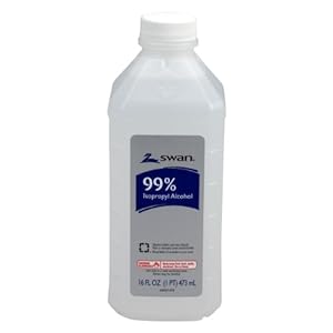

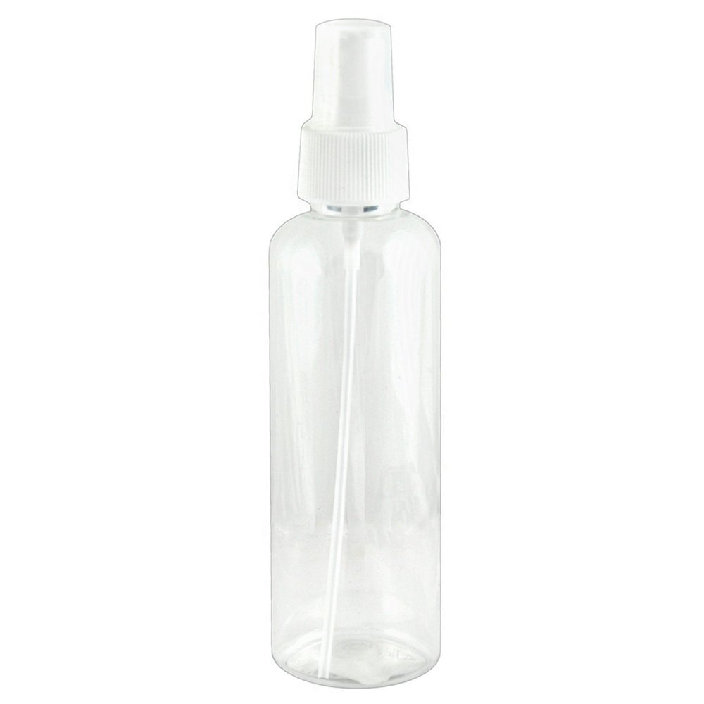

For the spray what you need is this:
Fine mist spray bottle..
99% Alchohol...
Canola oil... that is also great for cooking.
Mix as follows: 1:10 to 1:12 ratio.
This means for 10oz to 12oz of alcohol put 1oz of oil.
you might want to adjust this depending on your caliber but I would start with 1:12 and then
add a bit of oil later if needed.
Berfore spraying the brasss shake the bottle well.
Then spray and make sure that you spray a bit inside the necks.
I like to use a round plastic container that when you shake it most of the bult brass lands straight up so
it is easy to spray evenly and inside the necks.
Let it dry for a few minutes and presto!!
