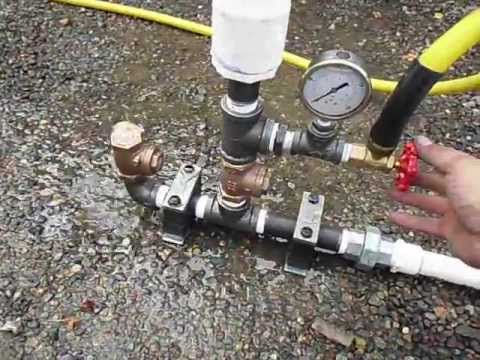

I fell down the YouTube black hole this morning and came across something I'd never heard of:  ram pumps.  With just a small amount of head pressure, you can pump water without any external power.
Powerless water pump
 The head requirements really depend on the size of the system. The video I posted is running on only 5 or 6' of head.Originally posted by Norm DeGuerre View PostI built one at my ex-girlfriends camp it pumps from a Seep to a Pond You need at least 10' of head to make them work u-tube is full of vid's on thisOld enough to know better, still too young to care
 Right, but like I said, it really depends on system requirements.Originally posted by Norm DeGuerre View Postyea, but you are only able to pump ounces of water per cycle at that ^P
 5 psi is enough to overcome some length of discharge piping, as well as some discharge lift
