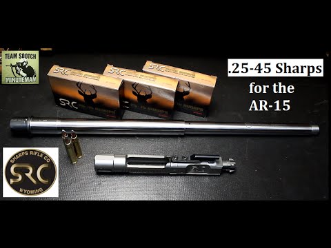

I saw a post by wildman about this caliber and I would like to correct a few things I saw in the video.
This wildcat has been around for decades under 257-223 25-223, 25x45, etc...
It is only now that it is being commericalized as a sharps company product and a great and simple improvement to the AR15.
Folks would consider this caliber due to the simplicity, cost effectiveness and the performance gain for hunting and also this makes
this round easy to shoot and reload. The ballistics are impressive when you look at the speeds and energy at the muzzle.
Now here are my comments and considerations of the above review:
- When he compares the energy he is wrong for both rounds. If one is going to compare rounds one needs to be very specific
about the rifle, barrel and bullet / cartrige.
- The sharps publishes the 87gr spreads from a 20" barrel that is a pretty good speed of 3000fps. and the muzzle energy
for that round is 1,739 ft-lb and not 1,384 ft-lb like they mention in the video... http://srcarms.com/wordpress/25-45-sharps/ammunition/
- The above speeds are achieved at 5.56 / nato type pressures that is fine both for the modern brass and rifles but when comparing
to a .223 one should use the same type of criteria. He doesn't mention what round he is comparing to but it seems he is comparing
the sharps speeds from a 20" barrel with a rather anemic .223 from a 16" barrel. If one chooses to use high performance round
at nato pressures also tested from a 20" barrel the numbers of the 223/5.56 round drastically increase. I am not sure why people
who are supposed to be professional do this. They need to be a bit more scientific and objective on their analysis.
For exampel the 5.56 75gr hornady superformance achieves 2,910fps from a 20" barrel with an energy of 1,410ft-lb.
http://www.hornady.com/store/5.56-NA...ormance-Match/
But this is something a lot of people miss that is very important. At 300 yards the 75gr hornady bullet is doing 2,240fps with 836 ft-lb while
the 25x45 is doing 2112fps with 862 ft-lb of energy. So the sharps is a bit slower than the hornday with a bit more energy but at 400
yards that continues to change and the 5.56 is faster and has more energy due to the superior in flight ballistics. See below.
Hornady 5.56 75gr hpbt Superformance.
25x45 SHARPS
- All is needed for the 5.56 is nothing, just a 5.56 ammo that is cheaper than the sharps.
I think where the sharps is great is in those areas where the 5.56 is not legal to hunt and in any case the 87gr
is a more appropriate bullet for white tail almost replicating the ballistics of the 25 savage.
