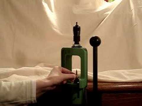

    I am looking for your opinion(s) for Meplat trimming and/or forming for accuracy.
    If you are trimming, what is your preference of tooling suppliers?
    What are you seeing for MOA improvement from 300 to 1000 yards?
    My interest is specific to 223, 6.5 and 30 cal

      I will give you some input here. I did some meplat trimming years ago and really didn't notice any difference. The groups were already touching most times and the accuracy loads didn't get
      any tighter. I also used bullet pointing. This also didn't see a substantial difference but I observed bullets where impacting a tad higher at long range so this was a sign that pointing increases actual BC while trimming might reduce it. At this time I switched from SMK to berger as Bergers were, and continue to be more uniform. I guess if you want to try something do something simple like taking off any obvious burrs with a very fine file and simply point them. That is a lot easier and faster and better imo.
      In the last 6 years I have been using more Hornady, including the Amax line that to me they are pretty consistent and a much better value for volume shooting. I am not buying many smk anymore. There is a reason sierra are now coming out with their polymer tipped version copying hornady profiles and tip design.
      Given you have super consistent brass preparation and loading/seating, I believe this is a lot more critical than anything you might achieve with uniforming the bullets.
      But if you want to do it use the pointer vs. trimming. There are guys out there that do custom pointing dies for your bullet brand, model and grain. It seems like snake oil to
      me specially seeing how folks are winning matches with out of the box bullets.
      But this whidden pointer does a good job and fairly easy, that is for sure...
