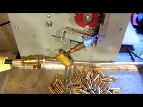

    I am always looking for ways to help with those tasks. I have a good annealing system but I think I want to improve it using a couple of old ideas.
    This is a good system the problem I see is that will not allow optional cooling. Also it doesn't have to be that pretty...
    A 6 to 8 seconds seems like a perfect time... Again same problem not cooling optional specially for short cases like BR norma....

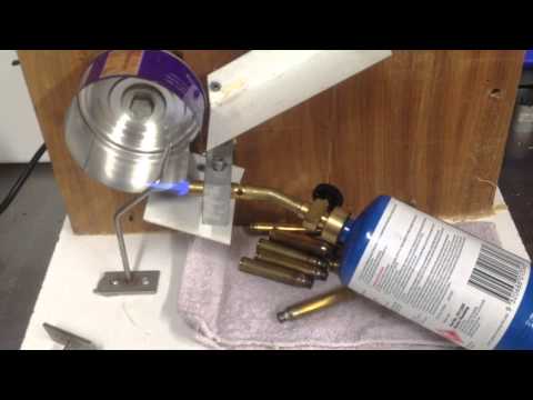

    This is as rudimentary as one can get...

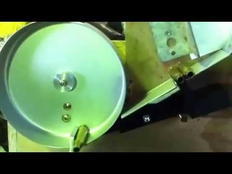

    So the feeder is great but I prefer something that works with a simple clutch and self indexes so there is no risk to coming out of sink
    or jamming and braking apart...
    This prototype self indexes but then I need to add the water.

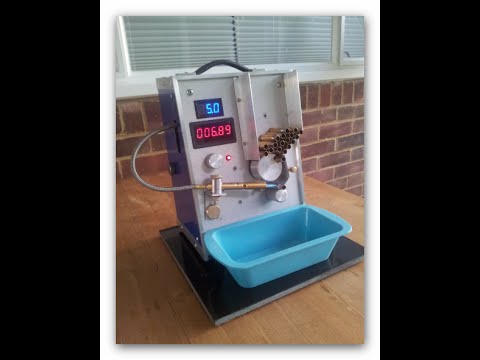

    I have an idea I want to try but having somethng that is completely automated that can do 200 to 300 cases with optional cooling it would be perfect for me.
    So I am going to use a cpu box as the frame and then try to integrate the cooling somehow.
    Any ideas, suggestions... give me a shout.

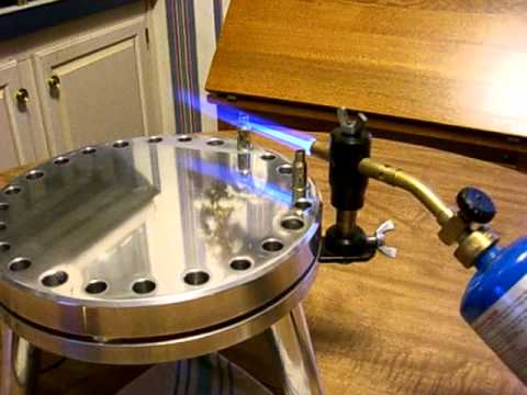

                    Rotating tray system....

                      A rotating annealer IN a water bath seems to be the best way to go, in my opinion, that way you keep the lower end of the case cool, and only anneal what you want done.
