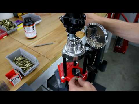

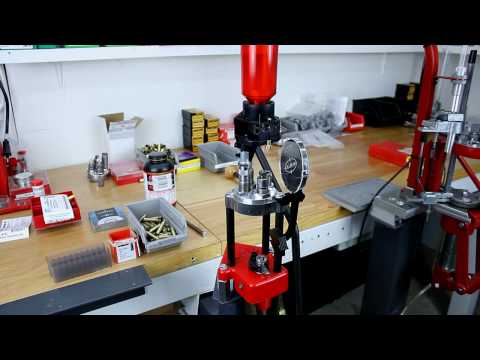

                              I found this video online that gives an idea on the turret. The only thing if one can get the press only dirt cheap and add
                              the priming and then I would use a case activated hornady powder measure. I would also add the lee trim system with
                              pilot but for pistol might not need it at first.
