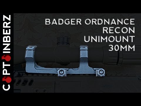

                        I think the Badger is hard to beat for the price but they do not have QD (For a reason too). How often do you swap them? there are some very small tools one can keep in the pistol grip for a quick change. The Geisselle (Sopmod certified) is also a nice one but IMO not worth the price step from the badger. You also have the Midwest new line with QD that are substantially beefed up. There are several OEM bases that are amazing. Not the ones that Burris uses that one can find under serveral brands and ebay but a beefed up.

                        But seriouly the Badger is hard to beat. Or the Geisselle that you have one actually certified for the 1-6 Razor. It is just money!!!!

                        Geissele.... like badger these are not oem...they have very nice machining capabilities. Their triggers are top of the line too.
                        Badger less sexy but they come with 20moa cant and also use the same screws and bolts you have in the military grade rings.
                        Think of it as two sturdy military grade rings coupled for extra support.
                        If you still want more cantilever the BO recon is a better option than any of the fancy ones people buy.....
                        review
