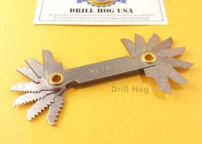

                            Haven't got those but do have pitch gauges that look something like this:
