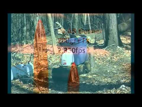

            • I was testing some rounds with the help of a very nice gentleman and I got some very good results.
              Here some quick testing of the 200gr FTX impacting at 50-60 yards.
              Muzzle speed is 2350fps and the impact velocity is around 2200 fps.
              2 x 1gallon water jugs plus a large big of loose wet dirt plus some paper stack and a couple of logs to trap the bullets.
              It seems the 200gr FTX are going to be white tail smashers.
              • Here is the video
